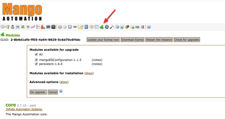

Check for Updates on the Modules Page
After logging in for the first time, check for updates on the Modules page:
