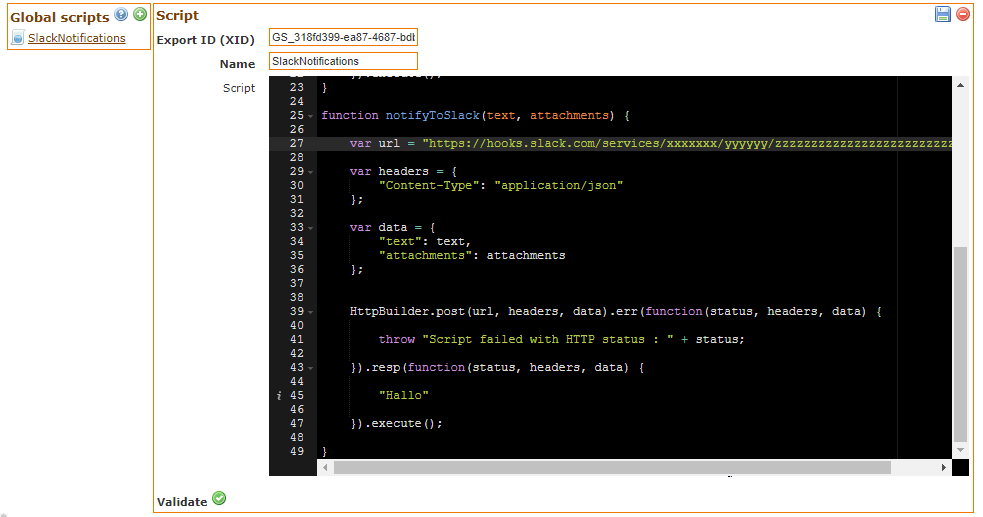

In Mango, you will need to create a global script where you will define a method to send notifications to Slack.
function notifyToSlack(text, attachments) {
var url = "https://hooks.slack.com/services/xxxxxxx/yyyyyy/zzzzzzzzzzzzzzzzzzzzzzzzzz";
var headers = {
"Content-Type": "application/json"
var data = {
"text": text,
"attachments": attachments
HttpBuilder.post(url, headers, data).err(function(status, headers, data) {
throw "Script failed with HTTP status : " + status;
}).resp(function(status, headers, data) {
"Hallo"
}).execute();

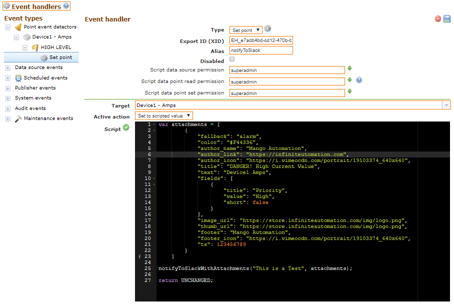

Once you define this global function, you will be able to use it in an event handler script.
var attachments = [
"fallback": "alarm",
"color": "#F44336",
"author_name": "Mango Automation",
"author_link": "https://infiniteutomation.com",
"author_icon": "https://i.vimeocdn.com/portrait/19103374_640x640",
"title": "DANGER! High Current Value",
"text": "Device1 Amps",
"fields": [
"title": "Priority",
"value": "High",
"short": false
"image_url": "https://store.infiniteautomation.com/img/logo.png",
"thumb_url": "https://store.infiniteautomation.com/img/logo.png",
"footer": "Mango Automation",
"footer_icon": "https://i.vimeocdn.com/portrait/19103374_640x640",
"ts": 123456789
notifyToSlackWithAttachments("This is a Test", attachments);
return UNCHANGED;
You have to setup the event handler as Set point type and you will need to add a target, but if you don’t want to change the target value, at the end of the script you have to add return UNCHANGED; line.
You can customize Slack messages and test how will be showed following the Slack documentation.
Finally, you should receive a notification in Slack when an event is triggered.
