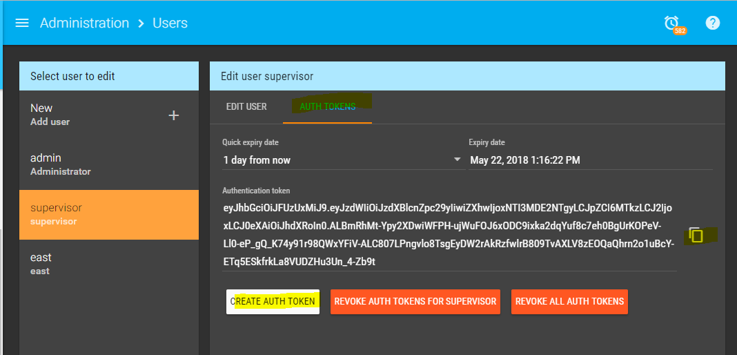

Token based authentication (JWT)
Token based authentication has been available since Mango 3.3.0. You can create a JWT (JSON web token) authentication token from the users page.
Once you have created your token you can use it to access the REST API by putting it into the Authorization header as shown below (note the Bearer prefix and space). No login or XSRF token is necessary.
